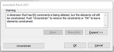

I am not sure if this is possible, but would like to ask before putting a nail in this coffin...
In Revit, if you EQ/EQ constrain elements via a dimension string, and then delete that dimension string - you get this warning.
Is it possible via API to 'listen' for this warning to show up, and hit Unconstrain by default?

I am pretty optimistic that that can be achieved using the Failure API. You can read all about that and other methods for catching and handling dialogues and errors in The Building Coder topic group:
https://thebuildingcoder.typepad.com/blog/about-the-author.html#5.32
I see lots of similar previous discussions here in the forum searching for "handle warning". Here is one of them which includes some sample code that may or may not fit your needs:
https://forums.autodesk.com/t5/revit-api-forum/error-handling-resolution-options/m-p/10480617

Thank you so much @jeremy_tammik for pointing in the right direction and carrying over some of the optimism 🙂 Will post my results/progress here

So I got it to work, probably not the cleanest way. I couldn't figure out how to do this using just
IExternalApplication or IExternalCommand, so ended up using both and not registering the IExternalCommand in the .addin file... IExternalCommand has ExternalCommandData with the UIApplication and IExternalApplication allows starting code when Revit is initialized.
Also not sure what I was doing wrong, but I could not PostCommand() either... I had the external command registered in the .addin file and I followed this article:
Either way seems to work well, and I am curious if my coworkers notice any performance issues.
