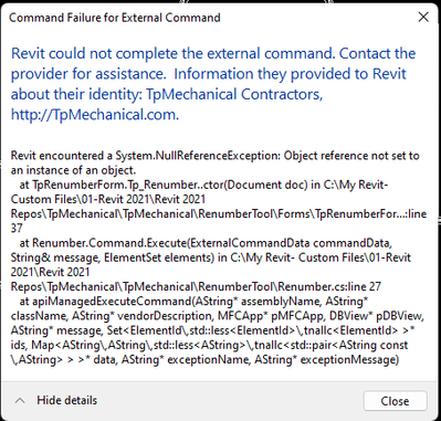

I tried setting the display member but now I cant get the form to show & I get this message.
Have no idea why I'm getting this. I've spent the last few hours searching for it but no luck.

Nathan.HilsonN67V6
Ended up remaking the form from scratch & works just fine. Thanks for all the help!
