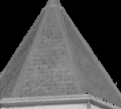

Sum-up:
When I create a structured RCP with Recap SDK, there are many missing pixels in the Real View seen in Recap application, whereas if I create a RCP with Recap application from exactly the same data, the Real View is fine.

Detailed results:
(Table with images doesn't seem to behave correctly.)
First image: 3D View. Second Image: Real View.
E57 file:
RCP created by Recap application:
RCP created by Recap SDK:
Question:
How can I get a correct (without missing pixels) Real View (2D panoramic image) for the structured RCP created with Recap SDK?

Thanks for the hint, this seems indeed linked to the scan resolution since, when I read the panoramic depth image from the different RCP, I can see that (see images below):
  • The panoramic images for all RCP have their upper invalid parts cropped: in the original data of my example, the half quarter of the top of the panoramic image is made of only invalid points; this part is completely absent from the RCP (both the one created by Recap application, and the one created by Recap SDK).
  • The panoramic image of the RCP created by Recap application is correct (except the missing invalid part at the top), whereas the one of the RCP created by Recap SDK is deformed.
Original panoramic image:Original panoramic image.jpg
RCP created by Recap application panoramic image:
RCP created by Recap SDK panoramic image:
When using Recap SDK, I only set numColumns and numRows of RCStructuredScanMetadata, and I leave the other fields unset. I think you once advised me to let Recap SDK compute automatically the other fields.
I tried different values for startElevation and endElevation, but in all cases this resulted in Recap showing a scan foot blank disc at the top (North pole) of the real view.
Please, do you think this is where the problem comes from? How should I fill the different RCStructuredScanMetadata fields? Which spherical coordinates system does Recap use (what is the elevation for top North pole: 0, π, π/2?…)
