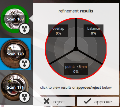

I'm trying to import Faro Focus Premium scan .FLS folders into Recap & have been having issues for a while now.
The data is there - have put the scans into SCENE & everything seems fine - regstration all good & data integrity seems ok.
When i do the same with Recap i get the following
I'm not sure what to do now - this is the same workflow as i've used previously (a year or so ago) - it's like the data is missing (although in SCENE it's all fine)
Any ideas what i'm doing wrong? Recap is updated to latest version.

What I usually do is process all scans in Scene first, then export all the FLS files back out after processing. I then bring the processed scans into Recap and it works fine. It'll take a very long time to initially start processing in Recap (30-60 minutes) if you've imported 80+ scans. I recommend doing a few at a time, letting those process, then do another batch, or just let it run over night.
I've also discovered if you use the Ricoh Z1 camera for creating the colored scans, then Recap cannot process them without doing the step above. I had a support ticket in for this and it's one of those "finger pointing" between FARO and Autodesk on who is responsible for the fix.

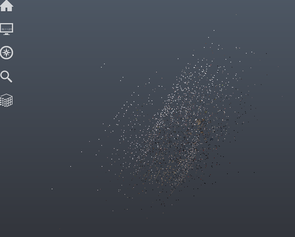

Hello
So we're still getting... whatever this is. Am running Recap 2027 - updated with hotfix.
Using Faro Focus Premium 70 - importing FLS folders directly into Recap.
What is going on.. what can i do here?
Our Scene license has expired & previous versions of Recap have worked.

Thanks @steveB4URL , Looks like we might need to take a closer look at this data to see why it is failing.
Would it be possible to share it with us? I'll DM you an email to send it over too.
