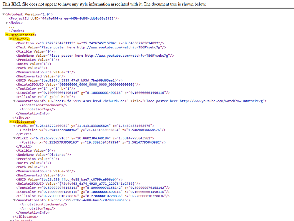

RCP is basically just a zip file containing an xml file, amongst others. You can check that xml file for your measurements:

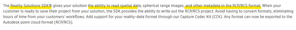

There is the so-called "Reality Solutions SDK" available from Autodesk. Not sure if you need to be an ADN partner to get access to it.

I have checked this on the AutoCAD website, The Reality Solutions SDK is available which has to do with 3D photos and photogrammetry. The Recap Pro SDK which deals with laser scan data is not available presently.
I just needed the limit box and cloud segment based on limit box to be made available thru the API or SDK.

I'm pretty sure the Reality Solutions SDK is exactly what you would need. From their website:
