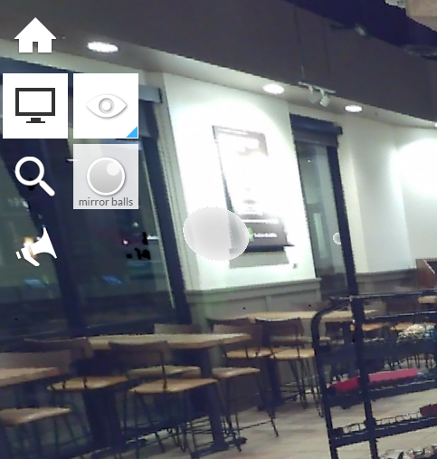

I'm not sure what you mean by 'black & white photo set'.  Are you referring to the intensity view?  You should be able to see that by toggling the display mode in RealView:
Yes I'm talking about the intensity view. It works fine in the actual ReCap program but in ReCap 360 we don't have that option. ReCap360.png
ryan.frenz
Ah, yes.  This isn't possible in the web browser version at the moment.  It could be worth posting to the Idea Station to get feedback/support from the community.
