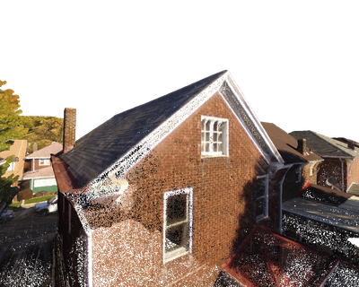

I'm using ReCap Pro for laser scanning projects.
When I produce ortho-images is there anyway to change the background to an image/have sky with clouds in ReCap,
There are options for solid and gradient colours but they are not quite what I am after.
I've attached a comparison image, ideally I would like both sides to have similar skyline if that makes sense (sorry for company branding, cant find the original!)
Many thanks
Steve

Thank you for the suggestion. Would a static image suffice for your needs, or would you be more interested in a full skymap which would track with camera movements?
Although ReCap Pro does not at the moment support custom images as backgrounds, images that are exported in the PNG format support transparent backgrounds which would allow you to easily composite in the background of your choice in an image editor or presentation tool.
Here is a sequence of images showing the workflow.
Point Cloud with a gradient background
Image Export
Select PNG format & the Transparency option
Result of Image export with transparency (white is transparent)
Public Domain image of the sky
Final Composite

Hi Marc
Thanks for the response, that looks like a viable solution and work through.
It would be great that if in an update something like this was added within ReCAP as it would just down on additional steps. I'm sure its a lot more complicated than what I'm thinking though!
Many thanks for the help.
