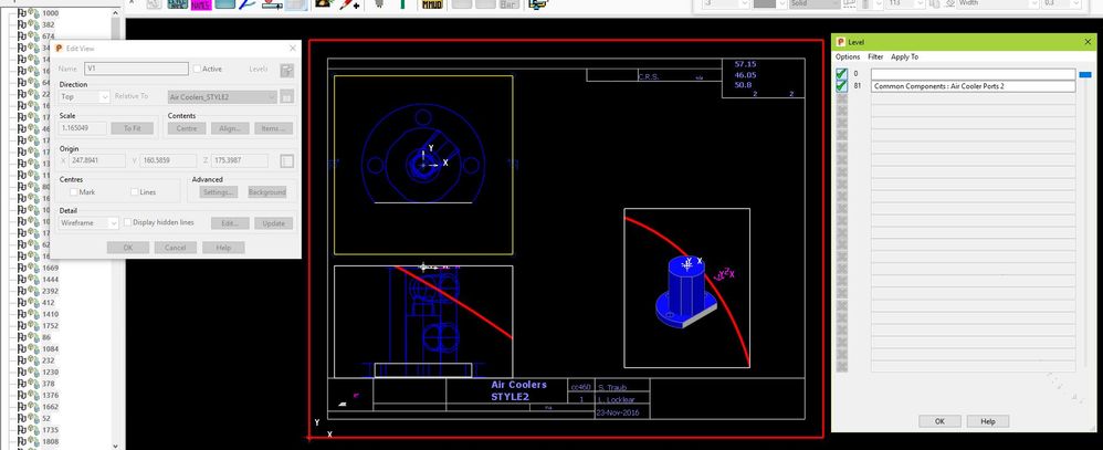

Hello All,
when I have close the model and I made some changes next time, and I want to update the drawing with these changes - new items are included in drawing and I can't remove them - even with add/remove items and update drawing.

a1moldmaker
most likely it is levels that have been added
while in modify use the levels manager to turn off levels that don't relate to drawing
Bruce Green
Saying I cant always leads to failure
Saying I tried MIGHT lead to success
Message 8 of 11
Nikola_Kolev
Your opinion should be joke ?
If you can't say something smart, better don't do it.
Message 9 of 11
a1moldmaker
i am going to assume there is a language barrier here considering your response is very rude and disrespectful.
when someone offers help or guidance it should be taken with gratitude as they did not have to bother with you in the first place.
with that said,
here is what i am talking about
this is a drawing i opening after a few hours of work....note many things that don't make sense are visible
this drawing shows the modify view open with the level manager open (filter set to used)
as you can see there are several levels turned on....(should only be 2 levels on)
and here you can see that the only level still on are the ones that pertain to this drawing view
this same procedure would need to be done to the other 2 views
if this still doesn't make sense then i will record a video of it to better illustrate how to fix this issue

Jon, please see below for the issue and the work around
it happens to all drawings (except limited view, not sure why this is exempt)
