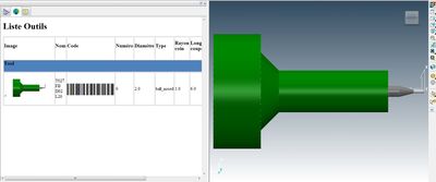

good morning to all.
I have a difficult project and I appeal to you.
we are going to buy a vending machine for tools, we manage the access with fingerprint or barcode, but we want to manage it from powermill so that the tools used in each project are taken. I had thought if there is the possibility of a bar code linked to a certain tool printed on the workshop sheet ?. we have a database with the manufacturer's reference, and this would have to be linked to our own code and that powermill convert it into a barcode, is that possible?

5axes
@kukelyk is right .. You just need to install on your PC the right true type Font ( joined to this post the Code 128 and a Code 39 linear barcode ) and specify in the HTML Code the Font used to display a string.
<TD><Center><font size="20" face="Code 3 de 9">123B02120</font></Center></TD>
or
<TD><Center><font size="20" face="Code 128">123B02120</font></Center></TD>
 You will get something like :

5axes
@rob_carriwrote:
that's what I want to achieve, but my knowledge of programming is very basic and I will not try to get someone to do it.
Nothing to program .. Just update your setup sheet .
Sample html code in the Toolpath.html  add the lines of Html code after the tool length description  :
	<tr>
          <td colspan="4"><Center><font size="20" face="Code 128">${tool.Identifier}</font>
		  <br>${tool.Identifier}</Center></td>
      </tr>
To get something like :
