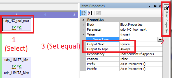

At the beginning, it did not work. There was an error in standart parameter :
but nothing serious Smiley Happy
after, I wrote the parameters as on the following screen and it works very well
Thank you very much for your help and solution, thanks to all those who helped me.
