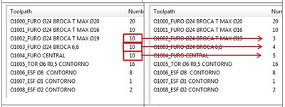

Hellou !
I have a macro that rearranges the tools that are repeated in the magazine because I have a limitation of 23 tools on the machine.
Today this macro replaces all the tools, even those that are in use, I would like it to rename only those tools that are not being used at the moment; Here is example:
Tools in the database                current macro         HOW I WOULD LIKE
T1 ESF 1                                             T4 ESF 1                                               T1 ESF 1
T2 ESF 2                                              T5 ESF 2                                               T2 ESF 2
T3 ESF 3                                               T6 ESF 3                                               T3 ESF 3
T4 ESF 4                                               T7 ESF 4                                               T4 ESF 4
T10 broca 4,2                                     T1 BROCA 4,2                                    T5 BROCA 4,2
T10 broca 5                                        T2 BROCA 5                                        T6 BROCA 5
T10 broca 6                                         3 BROCA 6                                        T7 BROCA 7
…In other words, do not touch the used positions, use empty positions

5axes
??? this macro doesn't rename any tool , it just change the toolnumber in a NCprogram according to the limits of the magazin.  I know it because I wrote it  and I'm using it for my own needs. And normally it doesn't change a Tool number if you don't need to change it ...   The only limitation is written in the heading lines :
//   Limite : les numéros d'outil doivent être tous inférieur aux emplacements disponible pour éviter des erreurs de traitement
That means in good english : the default tool number must be smaller than the magazin size , otherwise and especialy if it's the case on the first tool, the macro will change the tool number to 1 for the first tool and then it will be oblige to change every tool number. But in a normal use of this macro you should not have to change the number if it's not necessary.

Hello 5axes!
Yes it was you who wrote the macro in another forum! and I'm limiting the size of the magazine, but I did the test again and it renumbers the tools that are in use it should renumber by numbers that are not being used at the moment

5axes
Ok ..
First of all the macro works as it is suppose to work because it' not only a change of the tool number , but if the number of tool exceed the place in the magasin it split the ncprogram into different NCprogram. That's why If i need to change a Toolnumber I always start from a low number.

But .. we can improve it.
This is the new result with a Magasin list initialisation. I’m not exactly sure of the result. But it seem's to work also when It split the NCprogram into two.
We will have a problem if a tool number cannot be change for a tool placed in the first position of the ncprogram. In this case the result will be a split in unnecessary small NCprogram. But In this case I don’t have a solution except to go back to the first version.
