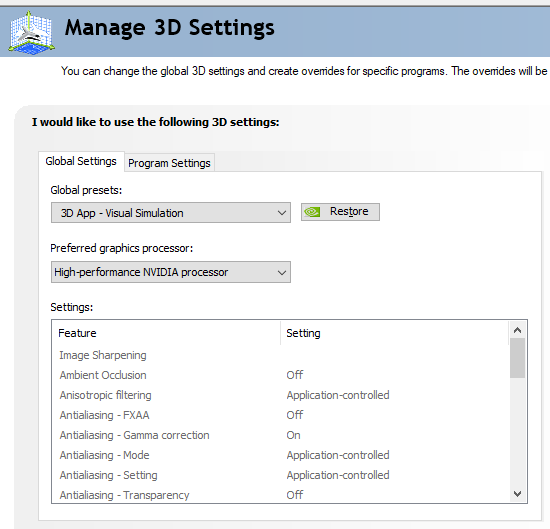

Maybe check your graphics card settings.  I usually set my Quadro card to 3d app - Visual Simulation, as opposed to just the base profile (see below).

Sorry for the misunderstanding.  I did not read your original post thoroughly.  I thought you were referring to the status bar custom fields.
So, if I create the same scenario, the expression field does not update like you are looking for if the strategy types are the same when selecting and activating in the Explorer (ie, Model area clearance, Model area clearance).
It seems to work if the toolpaths strategies differ upon selection and activation in the Explorer (ie, Model area clearance, steep and shallow, 2d curve profile).
Here is another quick screen capture of what I am talking about....... https://autode.sk/34TQV2N
I'd say it is a limitation of the expression being placed in a custom tab.  I suggest making a case directly to Autodesk to see if this can be addressed.  It looks to be a bug of some sort.
