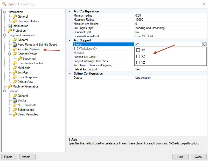

Hi. I also came to the conclusion that the problem is with the machine cnc. I guess your machine is a little old. To solve the problem, I suggest you avoid the movements of G2 or G3. There are two ways you can do this. Either require the post processor to create a G1 program, or use the redistribute command.
Message 20 of 21
tiago.sousaFRFK6
Hello in Point distribution change the output type to tolerance and keep arcs, and in tolerance factor put 0.5.
