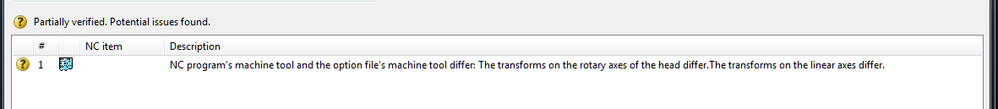

TK.421
This is a new feature to me as we never shelled out the bucks for the advsim license. I apologize if my question is elementary. How come after I verify a program and get the green tick, it turns back to purple after I deactivate the toolpath, or apply it to my stock block or whatever? I would think it will stay green as long as I don't mod the toolpath(s) itself?
Thanks!

here is a quick video of it happening:
http://screencast.com/t/OkqUXaZZLC8
EDIT:
I went back and re verified per the warning during posting, and I get this message below. I have a support ticket open on it, because I saw it yesterday. I'm sure the program is fine, but if it gives a green tick, I want it to stay green.
the numbers never lie
I'm not sure what you have in your posting macro, but we found that if you change the Machine Tool, Model Location, or Output workplane after the NC Program is verified, the Green check will turn to blue.
see attached
Hopefully you find the problem.
Bruce
TK.421
that was the case, Bruce. My posting macro sets my workplane to the output workplane. Even though it stays the same, the green tick goes away when it is re selected. I'll have to update some stuff....
