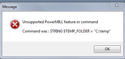

Thank you Rafael. I deeply appreciate it, but when I run the macro Powermill gives me an error saying, "Unsupported Powermill command and Feature: STRING

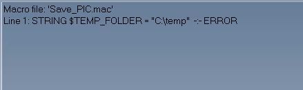

Message 6 of 20
I am currently using PowerMill 2010 and this is the error I'm getting below:
Message 7 of 20
This is the error given by PowerMill.
Message 8 of 20
rafael.sansao
Most macro commands do not work in version 10.
If you want to take advantage of the macros, you'll need to migrate to a newer Powermill version (2016 or later)

That's not possible. The logic programming language was inserted into the Powermill in the 2012 R2 version.
