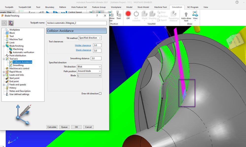

Hello.
1st : why powermill can not detect and solve collision between tool and model(tool ,not holder)(in tool axis = blisk)
 i know, if i use automatic collision avoid , I can prevent the holder and the model from colliding
But it works properly in automatic tool axis (with the same setting)!
2nd: in the blisk tool axis (with radial vector /angle= 20) The fifth axis is locked , but in the Automatic tool axis (with radial vector /angle= 20)The fifth axis is not fixed and has a rotation!

mark.cundy
Taking the second point first. With the Automatic tool axis, the target tool axis will be with elevation 20 degrees pointing towards the z axis, but this will be adjusted as necessary to avoid collisions (not necessarily keeping the elevation constant). The toolpath calculation will stop early at a point it is unable to safely machine a segment. You can however use tool axis limits to restrict how the collision avoidance moves the toolaxis.
The Automatic tool axis is the advisable option to use for blisks as it is designed to give a safe toolpath.
On the first point. The blisk tool axis (or anything other than automatic) will (by design) give a complete toolpath with no effort of safety (unless automatic collision avoidance is used). It is intended to be used as a last resort (when the automatic tool axis fails to completely machine the part) to provide a starting point for manual tool axis editing.

Meysam_Ghorbani
You did not give us a clear answer!
We need to lock the titillating axis in the Blisks strategy .for example 20 degree .Without any movement , Absolutely fixed.
Is it possible in PowerMill or not?

mark.cundy
You can use tool axis limits (with the same upper and lower elevation and 'move toolaxis') to fix the elevation angle, though it appears this may result in incomplete toolpaths.
Message 12 of 15
Note that the Automatic collision avoidance option controls the collision of the tool and the shank and holder.
And with the automatic method, you are not able to control the collision of the holder.

Meysam_Ghorbani
That was a good tip, thank you.
But with these settings, toolpath' order is disrupted
We also need the B axis to be locked at an angle.
And make no move.
