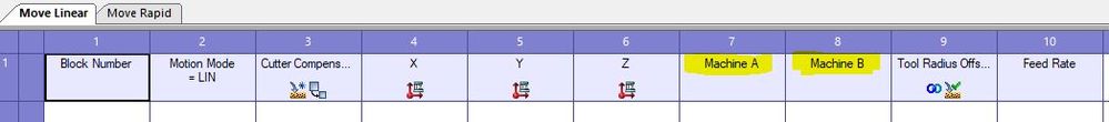

I modified the postprocessor you sent:
Reset Angles Only -temporary solutionReset Angles Only -temporary solution
Replace rotary _axis1_2020 and  rotary _axis2_2020 with Machine A, Machine B in Move Linear/Move Rapid Command.

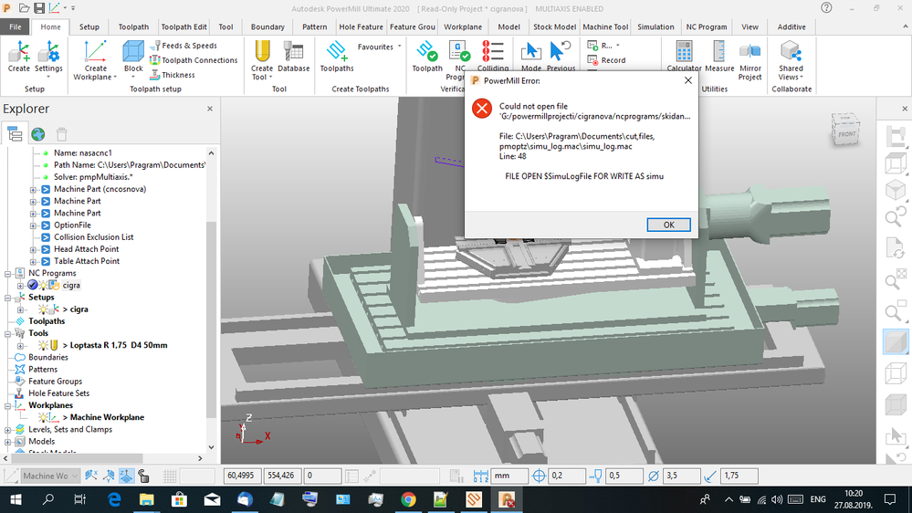

I create a simple macro that will help you compare machine simulation data to "wihout-RTCP" postprocessors output.
Need a short (macro working slowly) 5 axis toolpath activated, Machine Tool model activated, Model Location selected. Output is created in the project \ ncrpogram directory

The 0/ 360 a problem one possible solution:  extend teh B-axis range 0-720, then in  the Move Linear/ Move Rapid Commands change the Machine B parameter Value to expression:  "(%p(Machine B)%) % 360"  aka modulo 360.modulo360.JPG
The result:modulo360_result.JPG
Message 16 of 33
The macro previous version didn't always work, I didn't check the simulation_location().Component value, and the decimal point vs comma (1.1 != 1,1) also caused an error.

   REAL ARRAY Pos[]={0,0,0,0,0}
   $Pos[0]=round($Machine().X,4)
   $Pos[1]=round($Machine().Y,4)
   $Pos[2]=round($Machine().Z-$ToolLengthComp,4)
   SWITCH  $Config {
      CASE 'ABXYZ'
      $Pos[3]=round($Machine().A,4)
      $Pos[4]=round($Machine().B,4)
      BREAK
      CASE 'ACXYZ'
      $Pos[4]=round($Machine().C,4)
      BREAK
      CASE 'BCXYZ'
      $Pos[3]=round($Machine().B,4)
   $out=''
   INT I=0
   WHILE $I < 5 {
      IF $Prev[$I] != $Pos[$I] {
         IF $Out !='' {
            $Out=$Out+' '
         $Out=$Out+$Axes[$I]+$Pos[$I]
         STRING CMD='$'+'Prev[$I'+']=$'+'Pos['+$I+']'
         DoCommand $CMD
      $I=$I+1
Message 17 of 33

The Simu_log.mac not working if  you do not have full  access rights in folder. Folder name characters: A-Z, 0-9, '_'.
If simu_log.mac failed then type in PM command window:  "FILE CLOSE simu"
For testing use PP and macro, use short, simple toolpath.
Message 20 of 33
Poduhvat1
I'm not sure what is the problem the folder with Powermill project file is in My documents under the name powermillprojecti. Maybe because Powermill is installed at external hard disk. I will try to solve this.
