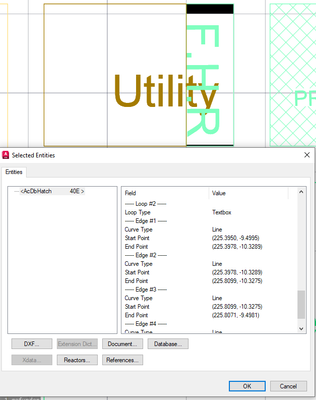

Message 10 of 14
tbrammer
It looks as if you created a external hatch loop using the bounding points of the MTEXT entity.
This is what SNOOPENTS from the ArxDbg.arx (<ARX>\samples\database\ARXDBG) shows for the MTEXT:
And this for the hatch:
If you use my code the inner loop will look like this:
Thomas Brammer ● Software Developer ● imos AGLinkedIn
