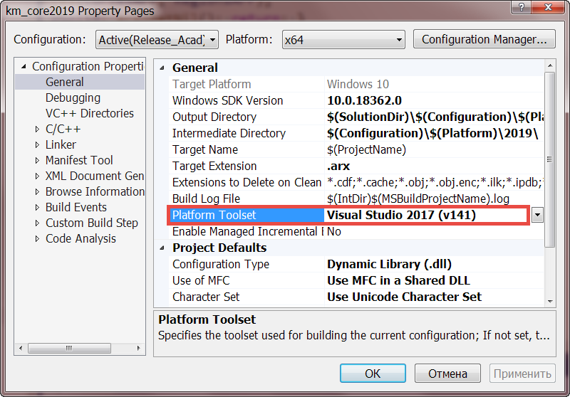

Alexander.Rivilis
It is look like you using VS 2019 instead of VS 2017. You can use VS 2019 only if set Platform Toolset to Visual Studio 2017 (v141):

@D_D_K
You should not use Platform Toolset v142 with ObjectARX 2020. All problems with memory management is due to using incorrect Platform Toolset.

D_D_K
thanks for your suggestion, so I will keep 2017 .
