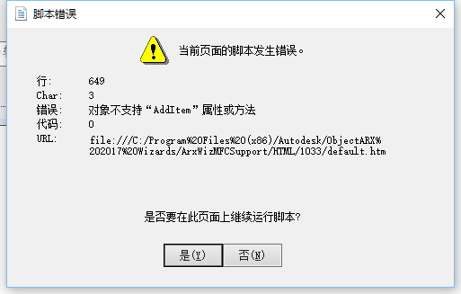

I got some troubles in creating  ArxWizMFCSupport class, it seems that the AddItem method goes wrong in the htm file,but the other classes can be created successfully, is there anyboady can tell me how to fix this? Thanks a lot.

Alexander.Rivilis
ObjectARX 2017? https://forums.autodesk.com/t5/objectarx/arx-wizard-2017-won-t-load-into-vc2015/m-p/6715960#M34684

Alexander.Rivilis
@Anonymous
Solution is:
Change in default.htm line 332:
<OBJECT CLASS="itemText" ID="DialogList" ACCESSKEY="d" CLASSID="CLSID:087da97a-e2f4-472a-bb48-0bcdfaa20fb3">

Alexander.Rivilis
For ObjectARX Wizard 2015...2016 and VS 2012 line 332 in default.htm have to be:
<OBJECT CLASS="itemText" ID="DialogList" ACCESSKEY="d" CLASSID="CLSID:76711522-ad75-437b-900d-aab0a64b6d83">

Thanks.It Works!
But,What's the meaning of "CLSID"? Can u tell me more ?

moogalm
Autodesk Support
Autodesk Support
CLSID- is class id, the unique way to identify the COM control here in our example Dialog, these COM controls are given by Visual Studio Wizard Template engine,
For some reason, latest edition of Visual studio, changed those CLSID, while migrate their templates, as our wizard templates are deriving from VS templates, it is expected that we need to change to same CLSID that VS Wizard template engine dialog control is referring.
It has been in fixed some time back in MFCDilaogControl,

Alexander.Rivilis
ObjectARX Wizard 2019 and  VS 2017:
1. File: "C:\Program Files (x86)\Autodesk\ObjectARX 2019 Wizards\ArxWizMFCSupport\HTML\1033\default.htm"
In line 336 have to be changed CLASSID to "CLSID:fc1ae18b-0282-42f1-90ae-bbd8f0181013"
2. File: "C:\Program Files (x86)\Autodesk\ObjectARX 2019 Wizards\ArxWizMFCSupport\HTML\1033\default.htm"
Line 11 have to be commented (or deleted). Otherwise dialog is wrong and impossible press Finish button.
