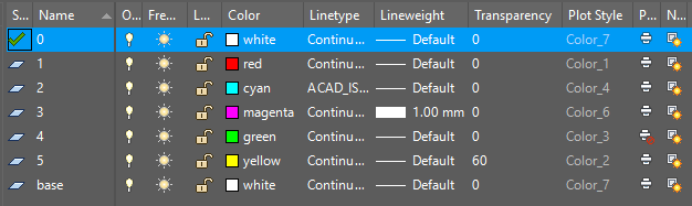

In the worlddraw/viewportdraw of my custom entity, I call AcGiSubEntityTraits::setLayer() several times to change drawing properties of primitives. But, only color and lineType are applied from layer. What about line weight, transparency and plottable/frozen/inactive?
Do I need to manually "sync" these properties? Something like this:
wd->subEntityTraits().setLayer(idLayer);
AcDbLayerTableRecordPointer pLayer(idLayer, AcDb::kForRead);
if(pLayer.openStatus() == Acad::eOk)
	wd->subEntityTraits().setLineWeight(pLayer->lineWeight());
	wd->subEntityTraits().set...
Note: I use layers as properties for my custom entity because it's very user convenient (layer = container of multiple properties).

maisoui
Yes for sure.
If I change these properties on the layer (of my custom entity), it is applied to all primitives which are yet another layer (i.e. subEntityTraits()->setLayer()).
A couple of illustrations:

Message 4 of 8
What Owen commented is about something like this:

Message 5 of 8
maisoui
Oh perfect, it works. I had not realized I had to do it after each setLayer().
