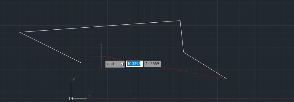

Hallo Guys,
I currently implement a AcEdJig class. It's working so far. Bit the original Entity isn't visible, no matter which setting I choose. I do
	return this->drag(AcEdDragStyle(AcEdDragStyle::kTransparent75, AcEdDragStyle::kHighlight));
The dragged entity is highlightet as expected. But there is no original entity at all. I've implemented the entity method. What could be the reason? Any Ideas?
Martin

Can you post a screenshot ? I doubt I have understood your query correctly.
Anyway, I have tried with your AcEdDragStyle, is this n't expected ?

I think I Mosunderstand something here.
this->drag(AcEdDragStyle(AcEdDragStyle::kTransparent25, AcEdDragStyle::kHighlight));
Thr documentation of AcEdDragStyle says:
This class allows clients to define the visual styles for both the original and the dragged entity during a drag operation. The client can define the visual style by either explicitly specifying the AcGiVisualStyle or by specifying a pre-set type that is used to set the AcGiVisualStyle.
What is meant by original entity?
Thanks in Advance,
Martin
