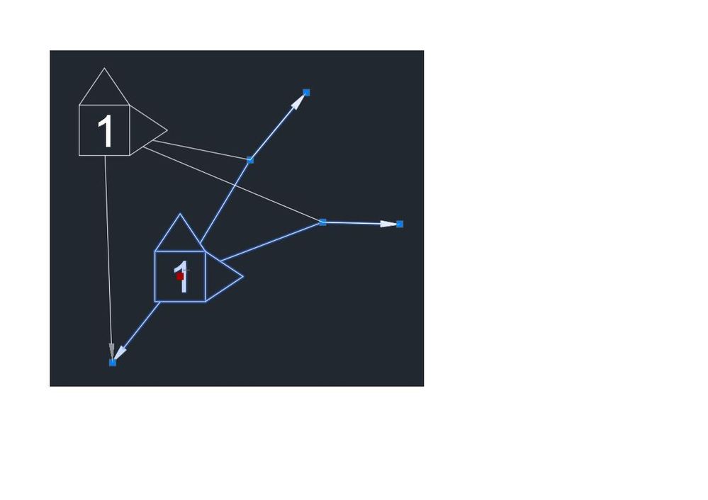

I have a point (P1) and a block and I need to find the point (P2) which belongs to the geometry of the block and whose distance is as short as possible between the known point (P1) and the block. In addition, the line connecting point P1 to point (P2) must pass through the base point (Pb) of the block.
It is practically what the Multileader command does when the attacment point is set to insert point.
It must work in the UCS coordinate system.
I tried to reproduce in the figure below.Get closest Distanfe from point to blockGet closest Distanfe from point to block
Thanks in advance.

You could write code according to following logic:
1. Call BlockReference.Explode() to obtain a set of entities in the place of the block reference;
2. For each known point (P1), you create a temporary Line object, starting at P1, and ending at the block reference's insertion point (or whatever point inside the block reference, for that matter);
3. Call Line.IntersectWith() against each of entities from explosion. Each IntersectWith() call would give you one or more points. Save these points in a collection;
4. After doing IntersectWith() again all entities from the explosion, test each intersection point for the distance to the Line's start point. The point closest to the line's start point (P1) is the point to find (P2).
5. Do not forget to dispose the temporary line and the entities from explosion finally.
Actual code should be easy to write.

I was hoping that there would be a function ready for this since the functionality I want is exactly what happens when I trigger the command to stretch through the grip of a multileader's block. See the figure below:Stretch Block of MultileaderStretch Block of Multileader
For reasons of compatibility of older versions I plan to implement this in a block with several leaders (not Multileaders) attached. This involves jig and I would like to make it as simple as possible since it requires a continuous update of the points.
As far as possible I will try to implement your suggestion.
