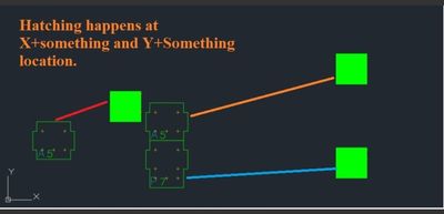

I want to hatch a block reference shown below. I am able to hatch it in solid, but the hatching is displaced by x distance and y height. I feel it's something related to z axis but I am not able to figure it out.
Can you please suggest something.
Special shout out to @Alexander.Rivilis
Code is below:

Message 2 of 8
Alexander.Rivilis
You have to take into account the conversion of the WCS in OCS. br.BlockTransform.Invert return such matrix.

Message 3 of 8
jlobo2
Ok, Thank You @Alexander.Rivilis
Once I do the block transform, how do I access those co-ordinates?
Message 4 of 8
Alexander.Rivilis
You have not transform block, but you have to transform coordinates with this transformation matrix.

Message 5 of 8
jlobo2
Ok. @Alexander.Rivilis ,
If you don't mind can you help me out with some code.
Currently I am trying to to this:
 Matrix3d tempMatrix = br.BlockTransform.Inverse();
 Point2d pt =
    new Point2d(
         tempMatrix.CoordinateSystem3d.Origin.X,
         tempMatrix.CoordinateSystem3d.Origin.Y);
         plBox.Normal = new Vector3d(0, 0, 1); //Vector3d.ZAxis;
         plBox.AddVertexAt(0, new Point2d(pt.X , pt.Y  ), 0.0, 0, 0);
         plBox.AddVertexAt(1, new Point2d(pt.X + 4, pt.Y ), 0.0, 0, 0);
         plBox.AddVertexAt(2, new Point2d(pt.X + 4, pt.Y + 4), 0.0, 0, 0);
         plBox.AddVertexAt(3, new Point2d(pt.X, pt.Y + 4), 0.0, 0, 0);
         plBox.Closed = true;
Message 6 of 8
Alexander.Rivilis
Totally wrong.  You have to use pt.TransformBy() method (but instead of Point2d you have to use Point3d)

Message 7 of 8
jlobo2
Ok, @Alexander.Rivilis
Something like this?
PlanarEntity tempPlanarEntity = br.GetPlane();
Point2d pt2D =
     new Point2d(
Point3d pt3D = new Point3d(tempPlanarEntity, pt2D);
Autodesk.AutoCAD.DatabaseServices.Polyline plBox =
    new Autodesk.AutoCAD.DatabaseServices.Polyline(4);
     plBox.AddVertexAt(0, new Point2d(pt3D.X , pt3D.Y  ), 0.0, 0, 0);
     plBox.AddVertexAt(1, new Point2d(pt3D.X + 4, pt3D.Y ), 0.0, 0, 0);
     plBox.AddVertexAt(2, new Point2d(pt3D.X + 4, pt3D.Y + 4), 0.0, 0, 0);
     plBox.AddVertexAt(3, new Point2d(pt3D.X, pt3D.Y + 4), 0.0, 0, 0);
Message 8 of 8
jlobo2
Great, @Alexander.Rivilis
I got that to work. Thank You for your help.
Getting the plane worked.
