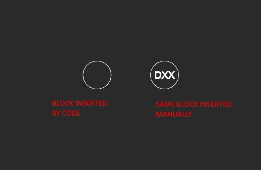

Hi everyone,
I'm trying to work with block + attributes, I can create it but if I insert it by .net hte block don't have attributes, if I
insert it manually the attributes are ok why?

Different from VBA/COM API used for inserting block reference (Model[Paper]Space.InsertBlock(....), if you have ever programmed in AutoCAD VBA, in Acad .NET API/ObjectARX API, you need to write code the add AttributeReference to the BlockReference explicitly. Something like:
'' Create new block reference here
'' Append block reference into space
'' Add block reference to Transaction
'' Create attributereference
For Each id As ObjectId in [theBlockTableRecord]
    If id.ObjectClass.DxfName.ToUpper()="ATTDEF" Then
        Dim attDef=DirectCast(trans.GetObject(id, OpenMode.ForRead), AttributeDefinition)
        If Not attDef.Constant Then
            Dim att =New AttributeReference()
            att.SetAttributeFromBlock(attDef, [blkRef].BlockTransform)
            att.TextString="zzzzzzzz"
            [blkRef].AttributeCollection.AppendAttribute(att)
            trans.AddNewlyCreatedObject(att, True)
        End If
    End If
Next
trans. Commit()
HTH

@twmerren , what do you talk about? The OP's code not creating and adding AttributeReference to the BlockReference's AttributeCollection is the reason. No having AttributeReference created, how/where the OP's code can set Visible property? I think you must mis-read the OP's code where a line of code setting AttributeDefinition(!)'s Visible property, which is commented out.
