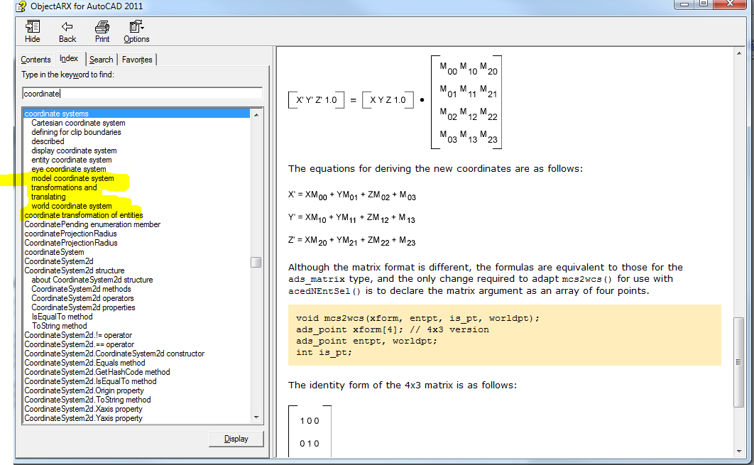

Open the arxdoc.chm and type "coordinate" in the index and look at the topics under it.
