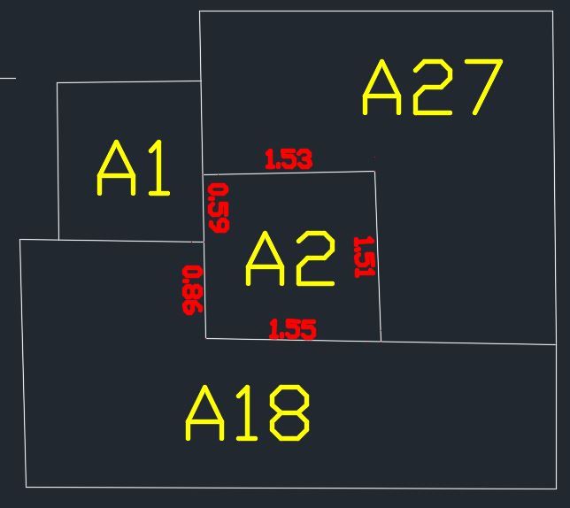

hakocivil
Thank you to all my dear friends for solving the previous problem.🙏🙏
Please consider the following figure. I would like to obtain an output similar to the following when I select the entire shape in AutoCAD:
1- Area A2, from the north with a length of 1.53, to area A27
2- Area A2, from the east with a length of 1.51, to area A27
3- Area A2, from the south with a length of 1.55, to area A18
4- Area A2, from the west in two parts: the first part with a length of 0.86 in area A18 and the second part with a length of 0.59 in area A1
In general, I want to identify the neighbors of area A2.
Of course, I need to do this for all areas. Also note that all shapes are drawn using lines.
