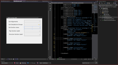

this my WPF code

ActivistInvestor
Are you familiar with how to create a Window like the one you show?
You need to create an instance of the Window and pass it as the argument to ShowModalWindow().

Aravinth.Pichamani
I'm familiar with WPF. I'm created above show picture. But when I'm clicking button not showing windows (wpf)
