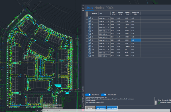

I've got something like this written already, and with the ability to solve for max pressure drop as well as velocity. I've been thinking about marketing it for fire sprinklers as well as landscape. DM me if interested.

Raindrop does looped systems via the EPANET engine. I haven't implemented all of the types yet, but the plan is to release a basic EPANET ->CAD interface later. I hear you on the interface, way too much time spent there, and I haven't even implemented demand scenarios yet!

I've been using xdata to store info on blocks(nodes) and polylines(pipes). With xdata I can filter by appname (EPANET_LINK) and easily grab all the links in the drawing. Data such as velocity, pressure, etc is stored as xdata on the polyline as well. The user can access that data via our properties panel.
I'm using native objects as well, one of my goals was to avoid custom objects. I do use groups to link pipes and flow arrows together, but I'm not completely happy with the result. I also use handles for tying together entities such as labels to objects. Writing handles as xdata leads to problems when the user copies entities around.
I looked into the C# EPANET implementation back in the day, but it needed too much work. I'm not doing any C++. I'm literally writing up an input file and evaluating with epanet2.dll I could see switching to a .NET version once I get more spare time (yeah right!)

We're using P/Invoke to call functions in the dll. I create an input file, run it, then query the model with ENgetlinkvalue. That way I didn't have to write a parser for the report values. You can iterate the links and nodes and write those values to block/polylines in xdata.
I think that's covered in the documentation, but I have to admit it's been a long time since I've looked at it.
