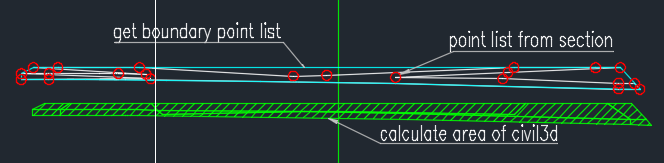

I do not understand what objective criteria allow you to retain certain points and to exclude others.
For example, a 2D convex hull would have followed the green line (here's a code code to get the convex hull from a point list).

I am using civil3d, i get the promiscuous point list from materialsection, I am looking to take the area of this point listimage.png

_gile
Ok,
To get the "boundary point list", you can use the following ConvexHull() method passing it the "point list from section".
You ca then get the "area" using the PolygonSignedArea() method passing it the point list returned by ConvexHull().
double area = PolygonSignedArea(ConvexHull(pointListFromSection));
