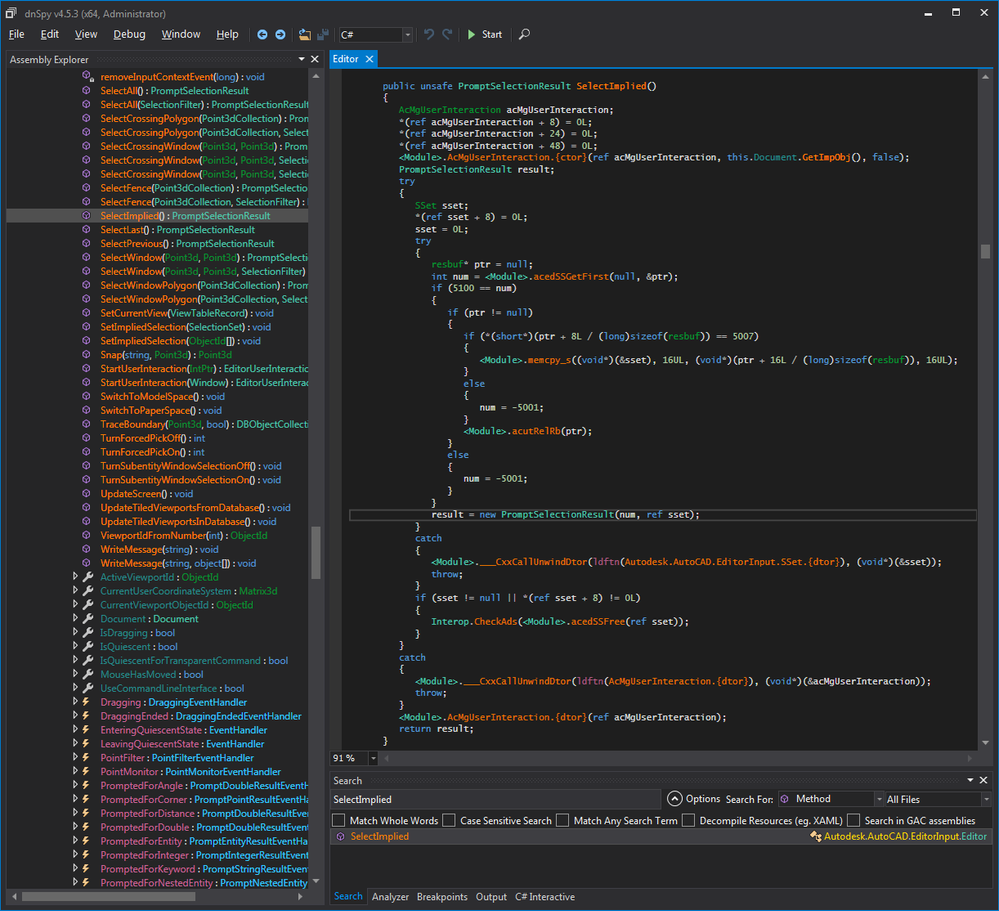

ActivistInvestor
 Hi @_gile
You really don't want to call SelectImplied() 3 times redundantly, because it has to do a lot of work.

@ActivistInvestor wrote:
 Hi @_gile
Thank you for the remark, it must have escaped me when I refactored this code.

@_gilewrote:
@ActivistInvestorwrote:
 Hi @_gile
YW, I just wish I had posted the right image, which was supposed to be this one:
