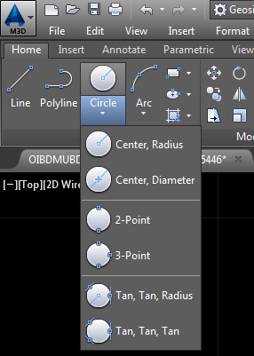

I'm a little problem with the RibbonSplitButton.
I wanted the current button contains the image and the action of current item, but the text I want it to be static.
The RibbonSplitButton contains a property called "IsSynchronizedWithCurrentItem" that does this, but it takes all information of current item.
I want behavior equal to the circle of ribbon autocad, where the text "circle" is static, as shown in the image below:
Below a generic code of how I did:

How can I keep the static text "circle" in the "IsSynchronizedWithCurrentItem" property as true?
1,036 Views
Jeff_M
Welcome to the Forums!
Use the SynchronizeOption property:
panSplitButton.SynchronizeOption = RibbonListButton.RibbonListButtonSynchronizeOption.Image;
