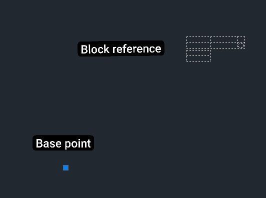

I want to insert a block reference to my drawing. Sometimes I have a problem with moving. When the block reference is inserted, the base point has moved away from the lines and lines will show in the wrong position.

What I expect:
 What happens after the code is executed:
In both images, the blue point is the block reference basepoint. In the second image, the code has placed the block reference in the correct place, but the entities have moved away from the base point.

Block editor - Before code execution:
Block editor - Aftercode execution:

What you see in the block editor is the block definition (BlockTableRecord) and the code you posted just insert a block reference (BlockReference). So the changes in the block definition cannot be due to code you posted.

What you show is the result of redefining the block to have a different base point. That has nothing to do with code that inserts the block.
Unintended changes to the base point of a block could be the result of defining or redefining the block with a current UCS that is not the WCS.
