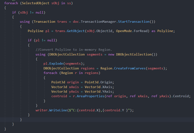

when i run my program i get a different  centroid point , please help me to get the correct  point thanks in advance
my program is : the user select polylines and i Convert Polyline to in-memory Region. but i get wrong centroid point.
this is My Code:

Try this one (adapted from GeometryExtensions).

If you want to go through the construction of a Region way, the code below should work but, unlike the one above, only if the polyline lies on the WCS XY plane.
