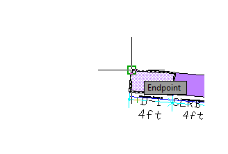

Hi Guys,
I use the following code insert block
            Using myTrans As Transaction = db.TransactionManager.StartTransaction
                Dim myBT As BlockTable = db.BlockTableId.GetObject(OpenMode.ForRead)
                Dim myBTR As BlockTableRecord = myBT(BlockTableRecord.ModelSpace).GetObject(OpenMode.ForWrite)
                'Insert the Block
                Dim myBlockDef As BlockTableRecord = _
                    myBT(Me.BlockName).GetObject(OpenMode.ForRead)
                myBlockRef = New DatabaseServices.BlockReference(InsertPoint, myBT(BlockName))
                myBlockRef.ScaleFactors = New Geometry.Scale3d(1, 1, 0)
                myBlockRef.Rotation = FixtureRotation
                myBTR.AppendEntity(myBlockRef)
                myTrans.AddNewlyCreatedDBObject(myBlockRef, True)
                myTrans.Commit()
            End Using
 After coe excuted new block has been insert. Then I found regardless I turn on/off onsap there is no sappoint on those newly added blocks.
It should looks like
my new inserted block
What did I do wrong? Any ideas ?
Thanks very much

Thanks for reply. I changed zscale to 1.0 , still no grip pointSmiley Sad
After more investigation. I found new inserted block display grip point, If I use "Line" command.
However once I run my own draw line function. the grip point turned off.
Even worse,after I run my own draw line code, back to AutoCAD "Line" command, those grip point never turn back

More investigation done, it is either a silly question or very strange one
Replication Step
1. Insert block(use the code I provided above)
2. type line command-->user can see new block grip point
3. Draw line use my code(code provided above)-->User cannot see grip point
4. Click Esc once, then type regen command, then type line command--> user can see grip point again
What on earth happened to my code
Please help

Thanks for your reply.
The code is not draw line, it is finding 2 point. while doing that I can't see new block's grips point however I can see others.
That's the strange part.
Any idea?
