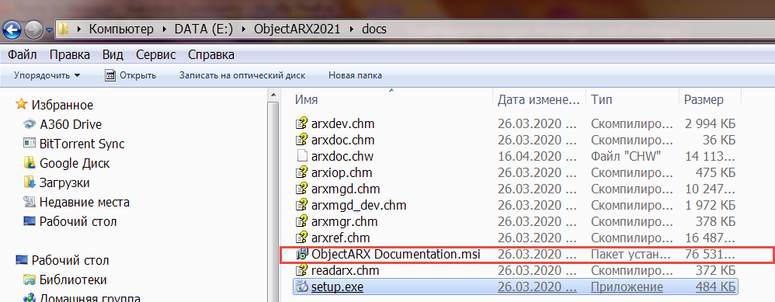

Intellisense for AutoCAD .NET API is based on xml-files in ObjectARX SDK /inc/ subfolder :
So if you use dll-assembles from this folder - intellisense is turned on

I am talking about standard AutoCAD .NET API assemblies, such as acdbmgd.dll, acmgd.dll, accoremgd.dll and so on:
E:\ObjectARX2021 - is my custom path for ObjectARX SDK 2021E:\ObjectARX2021 - is my custom path for ObjectARX SDK 2021

Oh! Ok... I think I got you... So if I reference the usual .dll (acmgd, AcDbMgd & AcCoreMgd) Visual studio should read the intellisense .xml from the same INC folder. Correct?
Message 14 of 15
Alexander.Rivilis
If you reference the usual .dll (acmgd, AcDbMgd & AcCoreMgd) from INC folder Visual studio should read the intellisense .xml from the same INC folder
