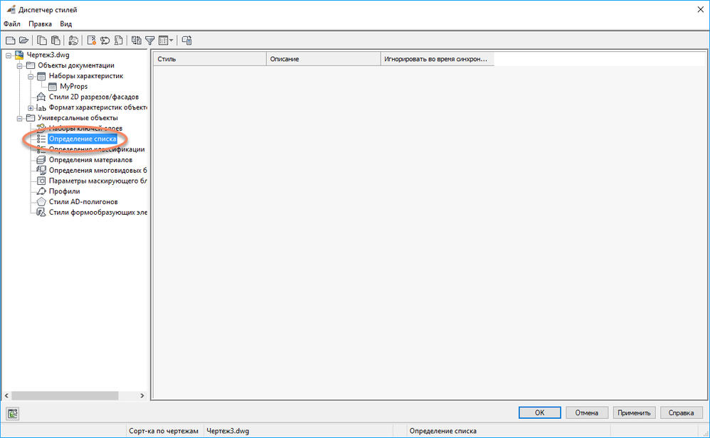

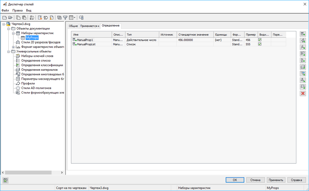

I can see my properties:props.png
But this list don't shown in the list definition area:no_list.png

Alexey.Terno
Need to add two lines:
listdefid = db.AddDBObject(listdef);
trans.AddNewlyCreatedDBObject(listdef, true);
Db.DictionaryListDefinition dict0 = new Db.DictionaryListDefinition(db);
dict0.AddNewRecord("MyList", listdef);
listdef.AppliesToAll = true;
listdef.AddListItem("fisrt");
listdef.AddListItem("second");
listdef.AddListItem("555");
