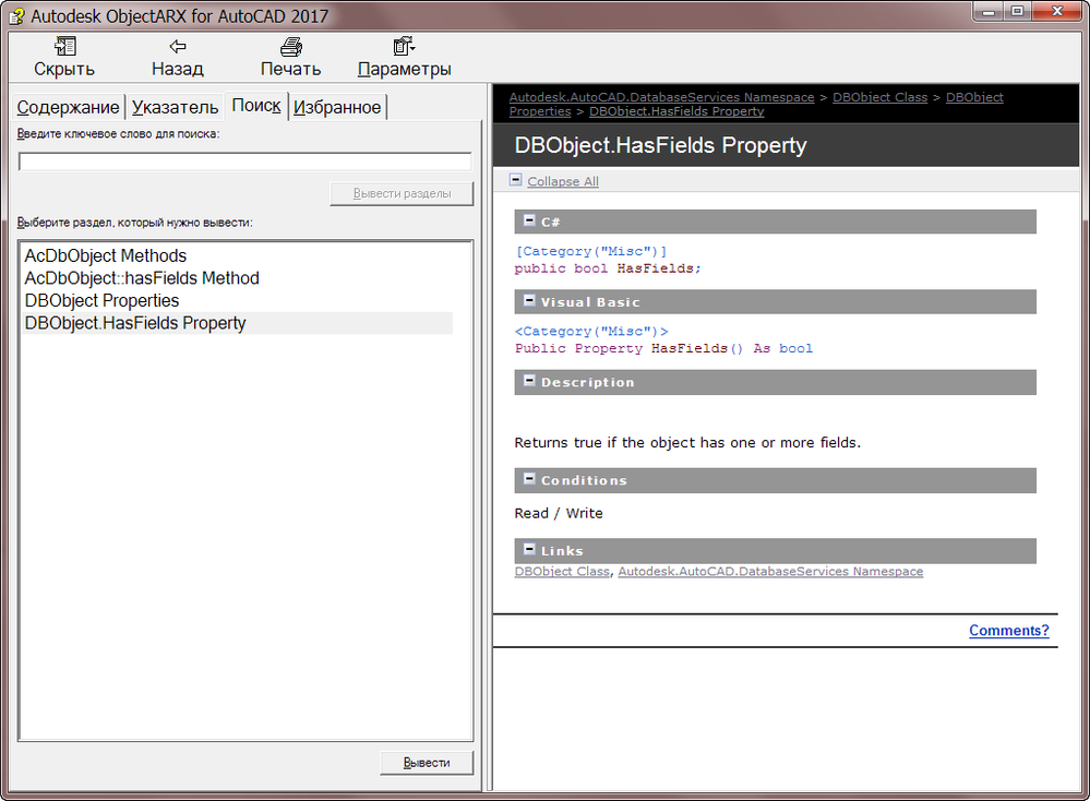

You can check value of myAttRef.HasFields in order to understand myAttrRef has field(s) or no.

AttributeReference class is derived from DBObject class. DBObject class has property HasFields:
 P.S.: What is a class AttRef in your's code? There is no such class in AutoCAD .NET API. Maybe it is a AttributeReference  class?

Alexander.Rivilis
@Anonymous wrote:
...Do I need a special reference to use .HasFields?...
No. You have to reference to AcDbMgd.dll and this enough to use HasFields property.

Alexander.Rivilis
@Anonymous wrote:
- For each attribute in the block it gathers some information such as the tag and the value of the attribute.
Exactly at this point in yours function GetAttributes you have gather also information about fields in attribute using HasFields property of AttributeReference. Your have to add new member to yours class AttRef with this information.

Alexander.Rivilis
Changed code:

              If myAttRef.HasFields = False Then '<------- Changed by Alexander Rivilis

  Dim HasFields As Boolean '<------- Added by Alexander Rivilis

        myRetAttRef.HasFields = myAttRef.HasFields '<------- Added by Alexander Rivilis

This worked perfectly.  What you essentially pointed out to me is that I need to define and ask for the HasFields property back in the Structure and GetAttributes function.  I wish I'd thought of that, and it seems so obvious now that you led me in that direction.
Thank you for taking the time to work with me on this.  I'm learning from you experts every time I embark on a coding project.
