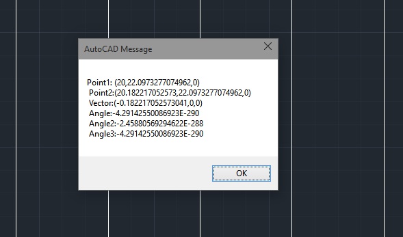

hello. Sorry for ressurecting a thread, but I have an issue using the "getAngle".
the problem is the angle I'm getting is nowhere in the PI range
all the "input numbers" turn out as expected.
here's my code:
                using (Transaction tr = db.TransactionManager.StartTransaction())
                    ObjectId id = res.ObjectId;
                    Point3d picked = res.PickedPoint;
                    var pline = tr.GetObject(id, OpenMode.ForRead) as Polyline;
                    Point3d onPlinePt = pline.GetClosestPointTo(picked, ed.GetCurrentView().ViewDirection, false);
                    Line3d perpLine = new Line3d(picked, onPlinePt);
                    Vector3d xAxis = new Vector3d(1,0,0);
                    Vector3d perpVector = onPlinePt-picked;
                    double myAngleRad = perpVector.GetAngleTo(Vector3d.XAxis, Vector3d.ZAxis.Negate());
                    double myAngle = myAngleRad * 180 / Math.PI;
and here's the result:
any ideas what I'm doing wrong?

Message 9 of 15
5thSth
true, it was por choice of expression.
my question stands, since I've been getting numbers 10e-188 no matter if I chose vertical, horizontal, or @ 45 deg objects
4 example, this is the result for a completely horizontalline - vector (1,0,0).
the angle to Y axis should be 90deg or PI/2 (1,57)
instead, I get this results...

5thSth
Ive tried it, but "angleToString" method:
                    var newAngle = Autodesk.AutoCAD.Runtime.Converter.AngleToString(Vector3d.XAxis.GetAngleTo(Vector3d.YAxis,Vector3d.ZAxis));
                    Application.ShowAlertDialog("Angle between X and Y axis is:" + newAngle);
and result angle for X and Y axis turns out to be "0" 😞
and if I try only to .GetAngleTo(Vector3d.Yaxis)  without Z ... : 314 (which is more of a "Rad" result.
-will keep experimenting; ty
but I'd still like to know what the problem was with other method ;
its not a "rad/angle" conversion problem. I know all about rads, and the results Im getting are nowhere near to expected rad or deg results.
to make the problem more apparent, I've rewritten the code to print the
angle to X and Y axis... which is "90 deg" or "PI/2" in rads which is equal to "1,57"
angle to X and X axis... which is "0,00 deg" or "0,00" in rads which equals to "0,00"
                    double      angleResult  = new double();
                    double      angleResult2 = new double();
                    angleResult  = Vector3d.XAxis.GetAngleTo(Vector3d.YAxis);
                    angleResult2 = Vector3d.XAxis.GetAngleTo(Vector3d.XAxis);
                    Application.ShowAlertDialog("axisX vector:" + Vector3d.XAxis.ToString() +
                                                "\naxisY vector:" + Vector3d.YAxis.ToString() +
                                                "\nAngle axisX to axisY: " + angleResult.ToString()+
                                                "\nAngle axisX to axisX" + angleResult2.ToString());
you can tell something is really wrong simply by looking at it... since angle1 and angle2 results turn out to be the same number!!! (-2,4785E +215)
Message 12 of 15
_gile
Ok,
It seems you really have a problem with your AutoCAD (try to repar or re-install it).
By my side, I got correct results:

Message 14 of 15
5thSth
on my desktop I get correct result.
but I tried to find where the bug is on laptop...
and when I run the dll directly from autocad, it gives correct result.
however, if I try to "debug" through visual studio, I get the above mentioned "error" results
Message 15 of 15
5thSth
It appears the problem was my windows. I was using windows 10 -Technical Preview
I upgraded to win 10, and the problem is gone (same visual studio and Acad and it works)
