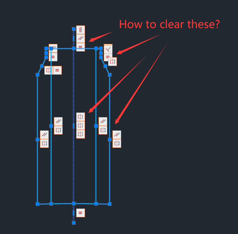

I want to explode a dynamic blockreference by code.
But there are many Geometric constraints.
I do not know how to clear these.
354 Views
wuziweiFQHA2
i got it, use br.ConvertToStaticBlock(newname);
Amriya_Exe
(defun C:prcl ()
(command "_DelConstraint" "all" "") ;
(command "_-PURGE" "All" "*" "No") ;
Save this as .lsp and run by command "prcl" after explode all blocks
