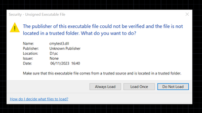

I do not build the solution on my colleague's computer and I use the same .dll to netload in cad
I am sure no  Trusted  warning appears .
I type 'netload' and choose the .dll and it says unable to .....
there is a warning appearing in my colleagues' CAD .
My colleague's warning is below
I am confused that there is no warning in my CAD!!
songmaverick
Option -> System ->Security Options
change the Security Level from High to Medium
songmaverick
Thanks for your reply , which reminds me of changing the Security Level
I could netload .dll

I had a suspicion it was a 'trust' issue becaue I've seen the wording of the message when cancelling the load from the Security dialog.
Glad it's working.

I set high security level before . So the warning would not come out .
Your reply reminds me of this ..
