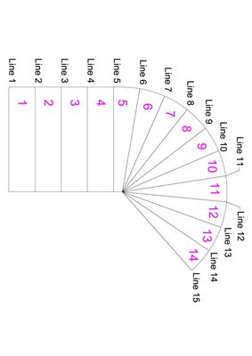

I open this thread to ask for help on extruding objects.
To explain what I would like to be able to carry over an image.
After selecting line 1 and then all other lines and arcs I would like to extrude each area by a certain amount.
Obviously after having selected line 1 I must be free to select the rest without being forced to follow a specific order; for example I select line 1 and then line 5, line 2, line 10, the arc, etc. or I select line 1 and then with a window I select everything else.
How could I do?
Thank you all very much, bye.

_gile
If you want to let the user randomly select the "lines" you must prompt him to specify the level for each selected line.
Also keep in mind that if you want to get extruded solids, you have to extrude Region objects, not only "lines".

mecoman6GF27
Hi.
My problem is not in the creation of solids but understanding how to identify the areas to extrude (area1, area2, etc.) after having selected the lines and/or arcs.
