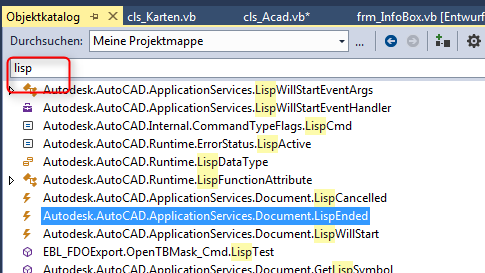

hi !
i want to define event when lispended. the Probleme i could not found by my autocomplete.
like the object catalog is part of Document.
but look my autocomplete
could someone help ??
regards Jan

Document.LispEnded/LispCancelled interface is exposed in Autodesk.AutoCAD.ApplicationServices.Document of accordmgd.dll. As long as you have that DLL referenced, you should have access to it.
In C#, to handle this event:
var dwg=Autodesk.AutoCAD.ApplicationServices.Application.DocumentManager.MdiDocument;
dwg.LispEnded+=myListEndedHandler;
in VB.NET
Dim dwg = Autodesk.AutoCAD.ApplicationServices.Application.DocumentManager.MdiDocument
AddHandler dwg.ListEnded, AddressOf myLispEndedHandler

You have to type: AddHandler before: doc.L, so that the intellisense displays the event handlers.
