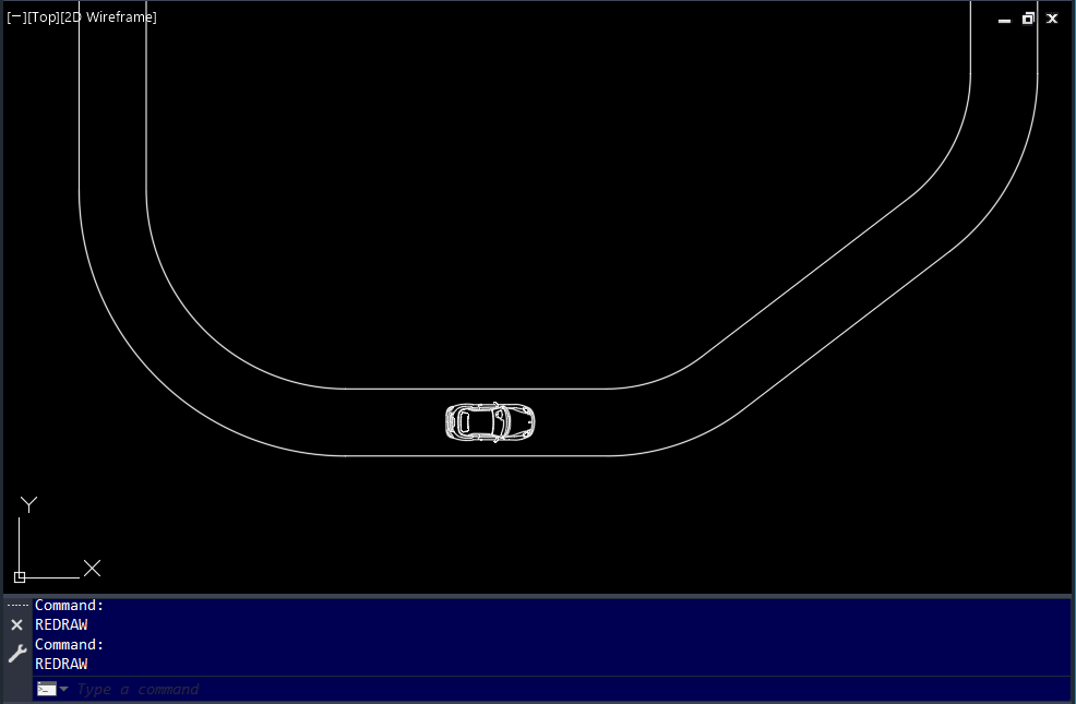

You say that the basepoint is constantly changing, which is fine in some specialized use-cases. You can set the BasePoint in each call to the Sampler() override to whatever you want, but in my own uses of Jigs, where the basepoint is not fixed, I just use a CursorType of RubberBand to draw a rubber-band cursor from the basepoint to the current cursor position.
In the clip below, the JigPromptPointOptions.BasePoint property is continuously updated on each call to Sampler() to be at the closest point on a curve to the current cursor position.
