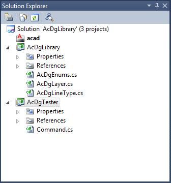

The Second project in the solution is for testing and has some examples on how to use the classes.
The Solution is created in Visual Studio 2010. The AutoCAD version I used is AutoCAD 2011 and is  coded in C#. My knowledge of VB.NET is limited but it would be nice if there is someone who could convert It.

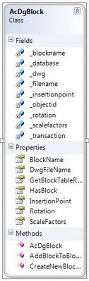

Had a little sparetime this weekend so I added a new class for inserting blocks.

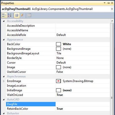

I’ve created a new control AcDgDwgThumbnail derived from the standard picturebox. I added 2 new properties to this control as you can see in the following picture.
The DwgFile takes a string value witch hold a dwg including it’s path. If the file exists the dwgthumbnail wil be displayed in the AcDgDwgThumbnail control.
In the test application I added a simple function to display a dwg’s preview. See printscreen.

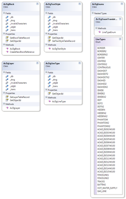

I have been busy rewriting my classes and tought it was about time to share theme with you all. I've structered the code so they all work the same way. Here is the new AcDgClassLibrary - Classdiagram.
Fot the next version i will create an new class for creating new dimensionstyles ad a block jigging class and wil try to document my code as best as i can.
