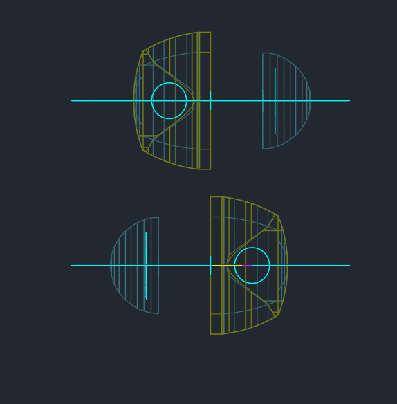

Hi all,
 is there easy way how to check if some block are overlapping? I have test DWG like on the picture. All blocks are on top level.... i mean they aren't nested. i tryed use BoundingBoxIntersectWith but it doesn't works. It is possible to use this command in 3D like that?

BestFriendCZ
Hi _gile,
thank you for the information. This loop is just a sample. In fact i only have two blocks in the list and i would like to know if they intersect in 3D and these two block should be intersect for sure

BestFriendCZ
Hi _gile,
I found reason why my BF does not contains any intersect points. Is there any solution for it... maybe use something different like BB?

BestFriendCZ
Hi _gile,
you are correct.  My problem is that my blocks have different rotation. If i set rotation for both block to 0 and change only their coordinates for example Z,Y so this function works exactly how i need. I need somehow transform BB by their rotations before compare.

BestFriendCZ
I try to find if some types of blocks are overlapping in space.
This function works correct "IntersectWith".... but only if these blocks have zero rotation. In another case i have to transform these BB somehow
