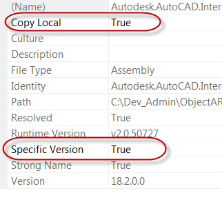

We are having the same issues trying to support 2010 to 2012 with COM referenced to our app. The only way it seemed to work for us is to reference the 64bit version of the interop and set the Copy Local to True and specific Version to True.
However, this does not work of 32bit on Windows XP but seems to work fine for Vista or Windows 7...I don't know why. In our case, we have to compile 2 versions, one with the 32bit COM for 32bit AutoCAD and another for with the 64bit COM for 64bit AutoCAD to make sure it works for all cases because our app is distributed to unknown users.
Hope this helps.
