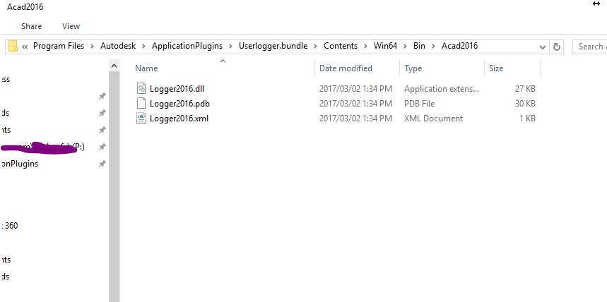

Now that I have installed and not copied the objectarx folders, now it doesnt want to do anything at all, even with the local copy set to true!
here is preview of my code, it works perfectly on windows 10, and now it doesnt want to work on windows 7 at all!!

Are you saying that it is not running using the autoloader mechanism of AutoCAD or it is not running inside of a visual studio session.  These are two decidedly different things.  You posted a pic of your plugin in an AutoLoader location but you are speaking as if you are running in a visual studio session.  Can you please clarify?
Also, are you using the save version of AutoCAD on the Win7 machine that you are using on the Win10 machine?  The autoload directories can be different depending on your version of autocad as well as the dlls that need to be referenced.
