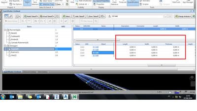

Hello! I would like to know how to overcome the following situation:
I have a road project in civil 3D that i extracted the solids and imported in Navisworks Manage 2018.
When I takeoff the quantities, all values like lenght, volume, are zero.
I´m using the english version.
thanks in advance.

phbeleigoli
michal.jujka thanks for trying to help.
I´m importing from civil 3d solids and it seems that navisworks isn´t recognizing the geometry of the solids.
and i have different tabs in my object properties.

As I can see you can quantity only volume. If you want know how do this let me know.

Thank you very much!! now I can have the volumes. Based on your answer and in what i could see in "map item rules", for those type of objects i can´t get the lenght and area. is that correct?
Message 8 of 8
You can quantity only value from tabs in properties. So if there aren't for example area and length, that is problem with your civil, no with navisworks.
