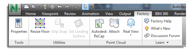

A client has Navisworks Manage 2020 and when he opens the file, he sees this bizarre grid surrounded by yellow & black stripes. It looks like a NASA Rocket Launch Pad or something. I downloaded the exact same file and I don't have this problem.
How can I "deactivate it" ? Very bizarre indeed.

that looks to be from the factory design ultilities
do you have this installed?

its this: http://help.autodesk.com/view/FDU/2021/ENU/?guid=FDU_About_Factory_Design_Utilities_html
do you see a factory tab in your Navisworks ribbon?

I see, so which button do you press to deactivate this grid ?
https://help.autodesk.com/cloudhelp/2019/ENU/FDU/images/nwf_ribbon.png

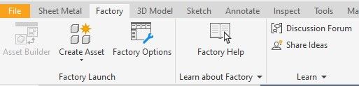

I have FDU (Factory Design Utilities) installed too. Just came back to a iPart parent and found this too (yellow and black caution tape border). The parent (master file) and members were all released. I'm not sure how this showed up either. I have FDU installed but I haven't touched it yet in leu of actual training. (would love to) Anyways this shows up in Inventor. I don't see a way to turn it off. Factory Floor Settings don't show up. Just Factory Options. Any clue?
(Inventor 2022.4.1, FDU 2022.1)
What I saw when I opened a Master iPart file that was releasedWhat I saw when I opened a Master iPart file that was releasedonly buttons on ribbononly buttons on ribbon
^all the buttons I see on the ribbon.
Cross Ref post from Inventor Forum: https://forums.autodesk.com/t5/inventor-forum/yellow-amp-black-caution-tape-border-in-my-model/m-p/1...

@jsanders
Hey, Try this...
Click the Nman icon jnewon_1-1685652903761.png  in the upper left of the screen and select options.
Then select Factory options and Grid floor. These should change the visibility of your Factory floor.
